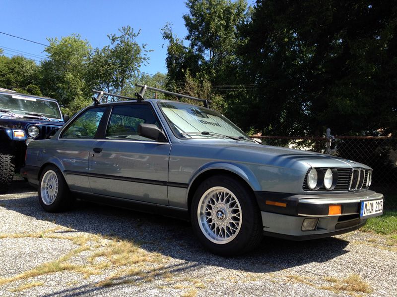

      No problem, I think it looks much better with the Ronal.
      Are you lowered are all? Where was it rubbing from?
      Hers mine with the same wheels.

        Yes the cars lowered. Bilestein HD and HR sport springs. Seems to be rubbing in all 4 corners, can't tell if its inside or outside edges.
        Nice looking ride.
