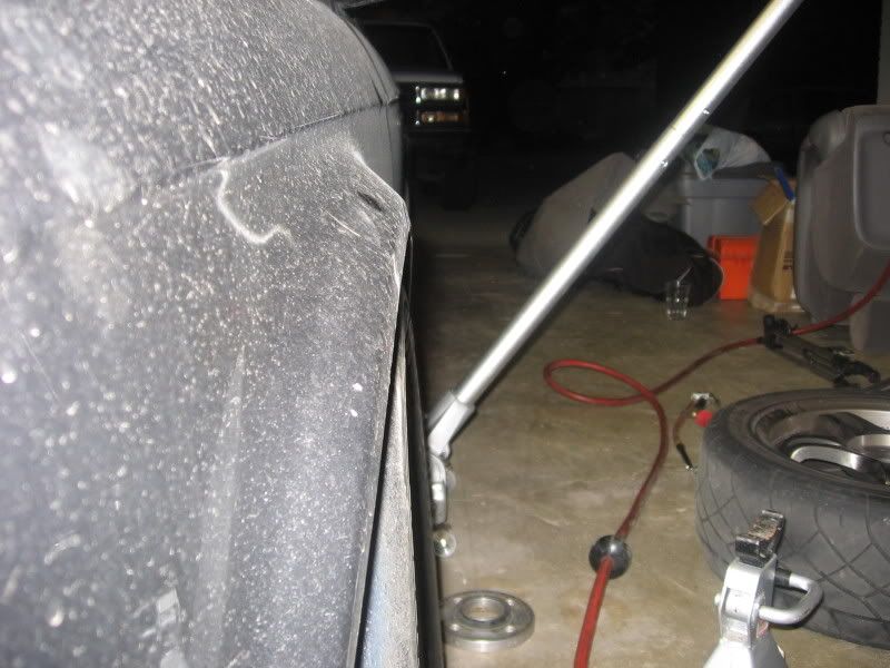

                        Somebody should try it. Just so somebody could say, "I told you so". I wouldnt even consider an 8" wheel without 225's though.
                        I bet I could fit them with 225's if I went with max negative camber, but that would be too much for proper traction.
                        The tires would stick out 30mm more than this
                        and that is with flared fenders and 3.7 degrees negative camber...

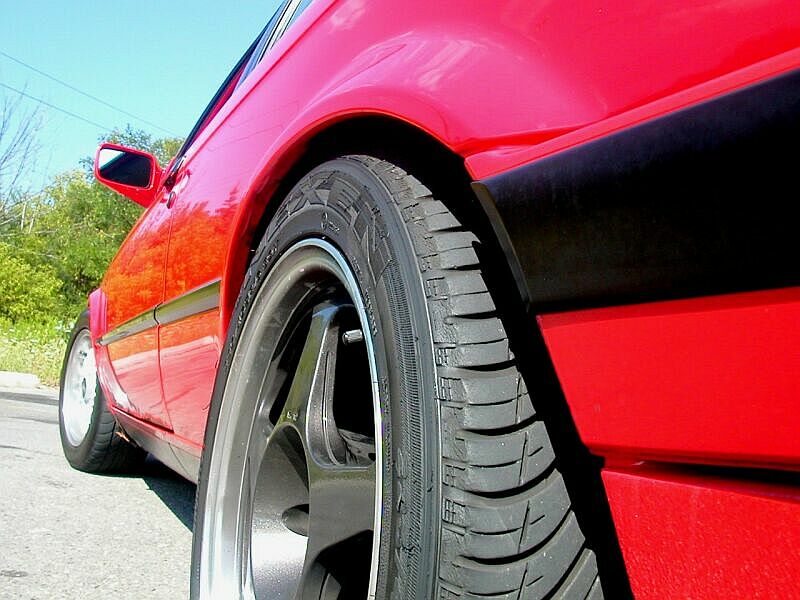

                            Here is a 16x8 ET20 wheel:
                            With a 225 tire, it rubs the stock fenders. If you want to run a wheel that is 20mm further out, your only chance is with 205 tires. And in my books, you may as well run 205's on stock rims. But people have different aims, so I'll just keep using the phrase "fit".
