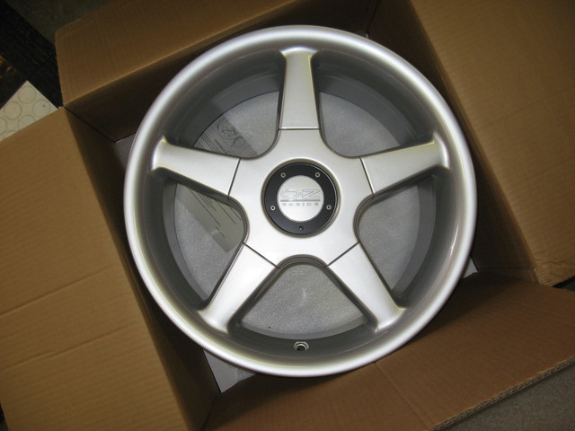

              I dont know how to make my own thread lol
              I recently picked up a set of monte carlo Oz wheels 17x7.5 4x100 et33 and Im trying to figure out what size hub rings I need/ if i should consider running hubcentric spacers.
              I did my best to measure, but I dont have the proper tool. I came up with 73mm.
