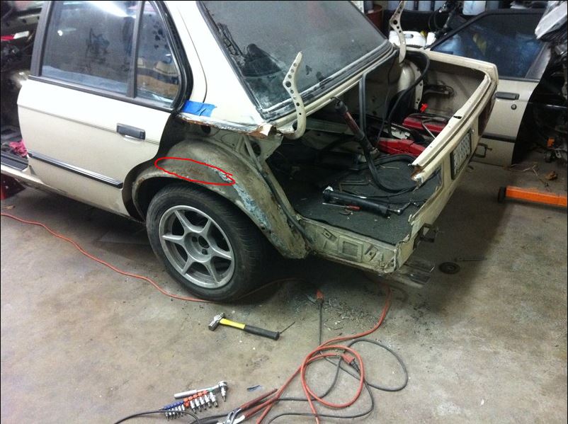

    Rubbing on the inside of my fender. Can I angle grind those 'bugles' flat and not ruin anything?
    Anyone know what I'm talking about.

    You can hit them in with a hammer, and as long as you don't go too far, it won't affect the outside sheetmetal.

      Perfect. I was a little worried about that. I'm glad I didn't look like an idiot with my verbiage.

              By any chance are you talking about that conduit piece behind the rear spring? Some cables go through there. Does anybody have a part number for that part? If not, I need to fab a new one. Mine's rotted.

                Are you talking about #21 in http://bmwfans.info/parts-catalog/E3...bon_container/.
                Its a cover for some gas tank vent lines.

                  I have a problem rubbing there too. I may give it a few taps with a hammer and see if it makes a difference.

                    Nope. Its near the lip. I'll take a pic this weekend. I'll have work to do.

                      This is what I am talking about. I was typing the reply when you posted!

                        you think an airhammer could pound it in?
                        that shit is thicc.

                          I hit it a few times with a 16oz hammer. I am a little worried about it showing on the outside... Still rubbing though.

                            You can grind it off or hammer it flat, been done numerous of cars, does not reflect on the outside quarter panel , but still do it with care,
