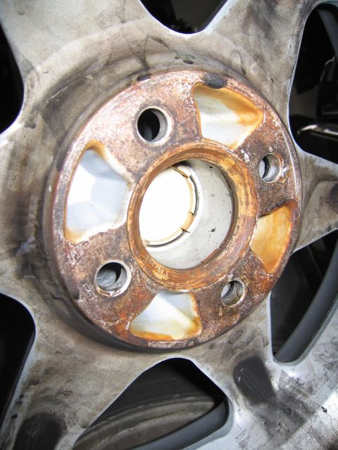

              Would 10mm hubcentric spacers work for me?
              If so, any of these any good?
              http://www.ecstuning.com/stage/edpd/...heel%20Spacers
              Are these junk? http://cgi.ebay.com/ebaymotors/VW-Je...261510004r8346
              Or these?
              Specializing in OEM, Aftermarket and Performance parts for Volkswagen and Audi's. Neuspeed, Neuspeed Flow Form Wheels, Solo Werks Suspension Coilover Coil over, Euro sport Accessories, WaveTrac Differentials, Bilstein Shocks, VW Parts, Audi Parts, Motorsports Racing Products
              89 325is track project / 05 x5 / 99 M3
              E30 stuff for sale | Parts I'm looking for
              • Mystikal
                Wheel Fitment Expert
                • 9602
                #2002
                Originally posted by bmwpower
                Might try in this thread instead...
                Or these?
                https://www.parts4vws.com/catalog/pr...mber=202345714
                They all look promising, although the beveled design could lead to issues with some wheels.
                I'd try the ECS ones first.

                  • bmwpower
                    • 1556
                    #2004
                    This the back of my wheel, with and without the ring.
                    Still should go for the ECS? I wish I knew the dimensions of the hub on the ECS and the others. That way I could check.

                            #2008
                            I really can't tell from pics.
                            This would likely be a trial and error process.
