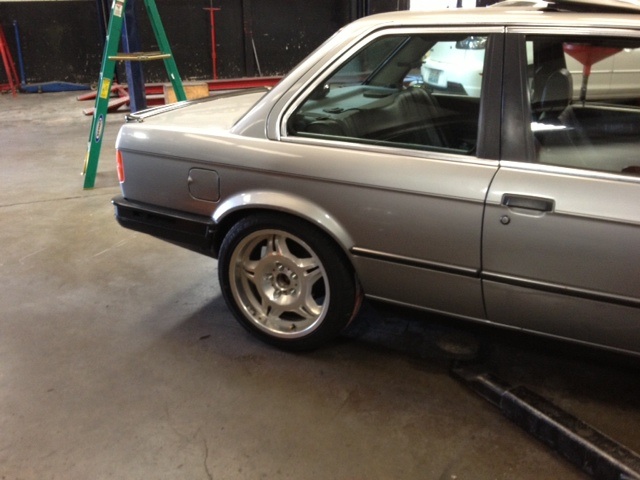

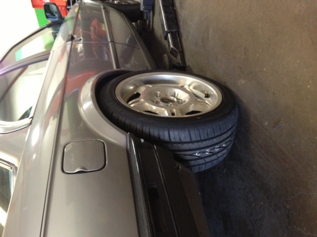

First fit e36 M3 rear 8.5
Mystikal
Very happy with my first fitting on the rear wheel. This is actually 245/40/17 on the 8.5 rear wheel. Will need slight roll on the fender, other than that, they are perfect... To me anyways.
Thanks, now the wheels are off to powder for some color !
