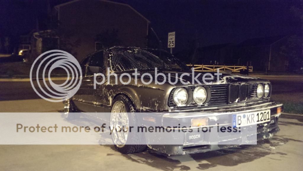

                    • mmmb00st
                      • May 2014
                      • 55
                      #8575
                      Excellent thread, Mystik. 8 years of fitment help and counting!
                      I'm looking to switch things up a bit. I am currently running 16s and fitment is as such:
                      I would like to go to a 17" wheel. I prefer a "girthy" appearance from the rear, as opposed to a smaller width wheel with spacers to flush it out. I would like to achieve a fit similar to this:
                      What width/offset/tire combination would you recommend to achieve my goal? Does anyone recognize the second car as a member here? Eg. - 17x8et25 acceptable?
                      Thanks in advance for any advice given.
                      -Brandon

                              • Mystikal
                                Wheel Fitment Expert
                                • 9602
                                #8580
                                -Brandon
                                That's Jordan's old E30. I think he was running 18x8.5 square with something like 245/35 front 255/35 rear. It rubbed from what I recall.
                                17x8 +25 is ideal. You can run this with 235/40/17 tires with just a fender roll.
