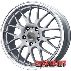

                              how about these ???
                              These are discount tires line of rims.........they are well priced. They are a 16x7 38mm offset. Id like to run 205/50/16's on them.........Think they will fit a stock soon to be H&R'ed sport spring-ed out 325 ?? Im thinking w/ a 10mm spacer maybe ??? Gimme some input, thanks
                              [sigpic
                                15mm spacers are what you're looking for. You can run up to 225/45/16 without even rolling the fenders if you'd like.
