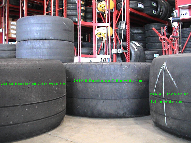

        Tire noob question here. Why is one wider if they are the same size? Is the rim wider on one of them?

          there is no industry wide parity regarding tire sizes/ratings. brand a's 225 might be way wider then brand b's 225. like s03's vs es100s, or hoosiers (run sometimes 20-30mm wider).

              The 225/50/15 Falken ZE-512 is only 8.9" wide on a 7" rim, basically the same as other 215 tires (like the 215/50/15 BFGoodrich G-Force Sport). All ZE-512's run about 10mm narrower than their quoted size. So it's not that the R-S2 is that wide (it's the same as other 225s), it's just that those Falkens run narrow.
              As a side note, the steering feel difference when I went from the 185 winters to the 225 summers made me laugh like a pirate. Parking for the first few days felt like a manual rack.
