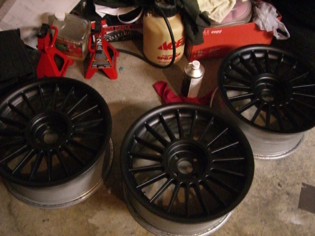

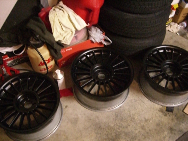

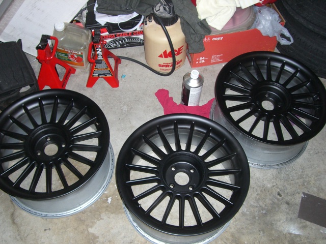

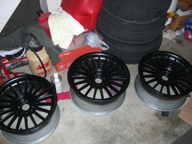

    so i decided to repaint my Kopis since they are rashed up and paint is fading, heres my story:
    1.first i washed them and scrubbed them with a kitchen scrubber sponge and wheel cleaner.
    2. sanded the lips with 100+200 grit sandpaper to take out rash on lips:
    3. sanded the rest of the face with 300grit+400 grit just to scuff it up:
    sanding station...
    4.wiped the wheel faces down with acetone.
    5.spray first 2 coats of Duplicolor Engine Enamel Low Gloss Black:
    6.sprayed 3+4 coats 10 min between each coat per manuf directions, heres the final product, they arent dry yet though:
    TA-DA!! im back-to-black baby. im really diggin it, new look for Bfest.:drink:
