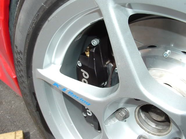

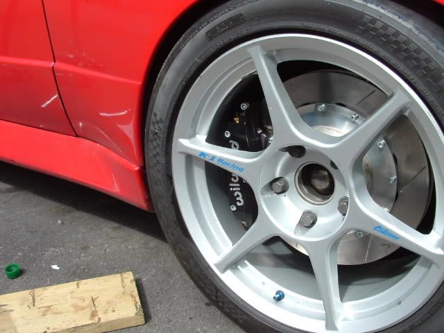

        The K1 are on special at Tire Rack. Tough and light wheels. They will be easy to find replacements down the road. They are et40 and will require spacers.
        The TD are a bit pricier, direct fit (no spacer) but heavier.
