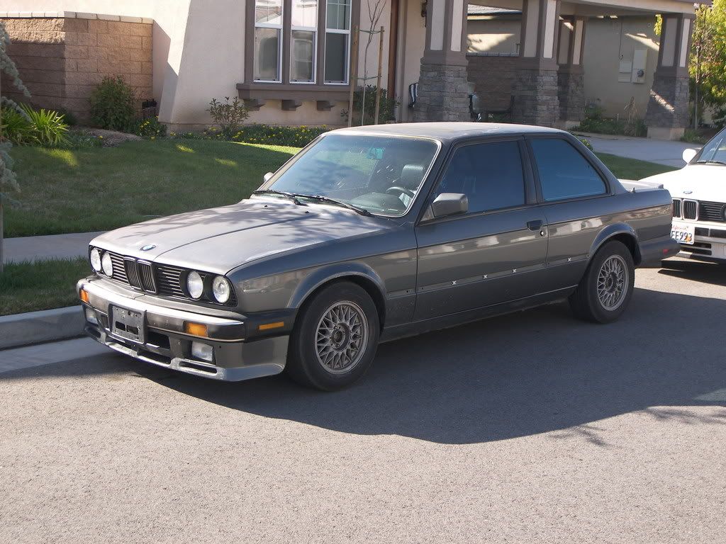

    looking to upgrade my tires, i would like to keep the 14inch wheels i have, what is the widest 14 tire i can run? 225?

    14 by what? 6, 6.5, 7?
    225 is about the limit on a standard-issue e30 rim. You looking at street rubber or R compounds?

      something for the street, they will be going on a bottle caps

          I put 205/60/14 Falkens on a set of weaves, which are 6.5" wide. They fit nicely and don't have any sidewall bulge. On a 6" bottlecap I wouldn't go any wider.

            there really aren't any great street tires in a 225 / 14" size.

              Aggressive summer tire: 195/60/14 Falken RT-615
              Good daily performance tire: 205/60/14 Falken ZE-912
              Don't be fooled by the width, the RT-615 will be a lot more capable than any other 14" street tire.
