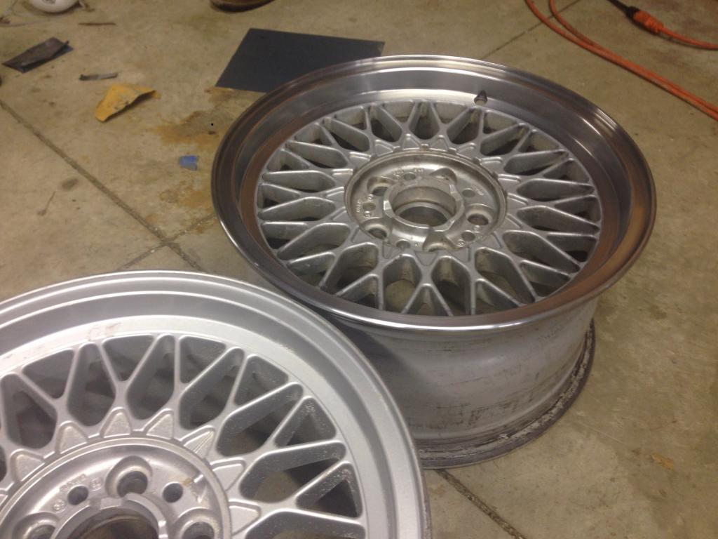

                  Just thought id share a before and after of my e38 style 5s with half polished lips. Need to get some higher grit wetsand paper before the lips are finished but after that I'm going with gold faces and caps. Thinking about going with a black barrel but not sure any ideas?
