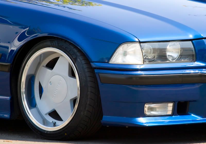

                Polishing is super easy once you get it down.
                Just takes some time an work.
                Depending on the condition on the wheels start around 320grit and work up to 2000grit.
                Then get out some compound an polish away.
                Heres my Type As with that process
                [Avus Blau] [UUC] [Borbet] [Tein]
                • Edgars325e
                  • Jun 2008
                  • 179
                  sexy ass wheels man i like them A+
