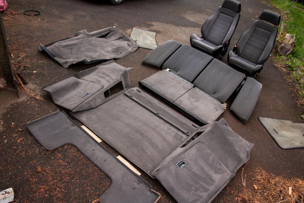

      FWIW I have my touring carpet out of the car if you want to see some pics to compare to a sedan carpet. I'm not sure how they compare either

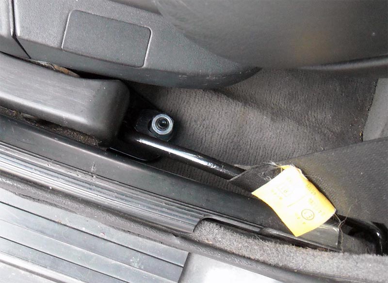

        Thanks for the info, looked closer today and I even think the carpet that's in my touring has been swapped with a coupe one (has the hole where the seatbelt bracket attaches)... so I'm at this point thinking I can definitely make a sedan carpet work.
        As far as the rear, basically everything you see, the right/left pods, the main carpet.... Using this pic for reference (see attachment)
          if you can post a pic that'd be great... wouldn't hurt anyway
              Do you mean there is a visible hole in the carpet? That would suck for me, since I have a nice grey carpet out of a coupe waiting to be installed in my touring.
              I've read all over the place that the only difference in coupe/sedan/touring carpets is the piece that covers the front of the rear bench, but I did not think about attachment point holes before buying the coupe carpet.
                When I bought my touring, I had no trouble sourcing mint Anthracite front comfort seat cushions with a wtb ad here on r3v. Should also be easy to find sedan door panels.
                Anthracite cloth is the most common touring interior, so finding the touring-specific parts in Europe shouldn't be too hard. You just need to find sellers that are willing to ship to the USA. Here are the sources I 've had good luck with for used touring-specific parts. You might be able to find someone breaking a touring and get most of the interior parts at one time.
                e30owners.com
                e30zone.net
                ebay.co.uk
                Cory
                Thank you for the info Cory. I've held off on posting a wtb just cause I wasn't sure if there's a difference btw touring and a sedan, but I'll just go ahead and do that. I've looked on ebay.de with not much luck, though my german is not exactly good haha
                The issue with carpet is it's lhd/rhd specific. So need to keep that in mind when searching for across the pond parts.
                I'll try to get a picture of the "hole" but this is for reference:
                - Sam
                • cory58
                  • 1021
                  Thanks Sam! That pic helps. Looks like I'll either be living with visible holes or sourcing another carpet.

                    Here's a quick snap of the touring carpet -
                      Here's a pic of the hole in my car. BTW, someone told me you can cap that. Not sure...
                      - Sam

                          Slightly better pic while out cleaning the carpet this weekend:
                          '89 318i Touring
                          '90 Miata
