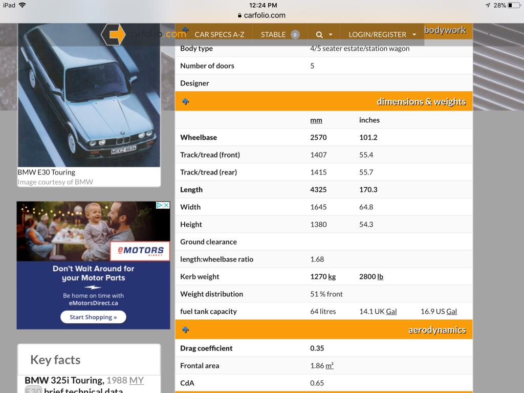

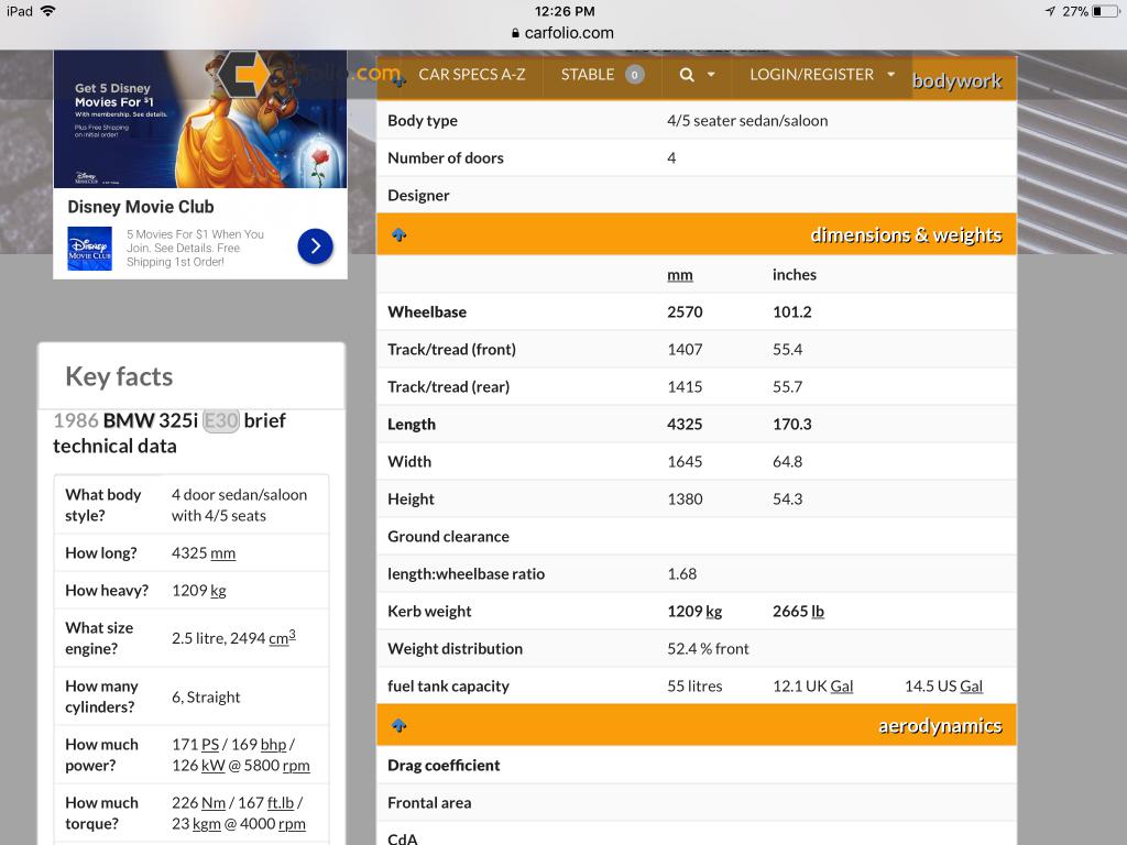

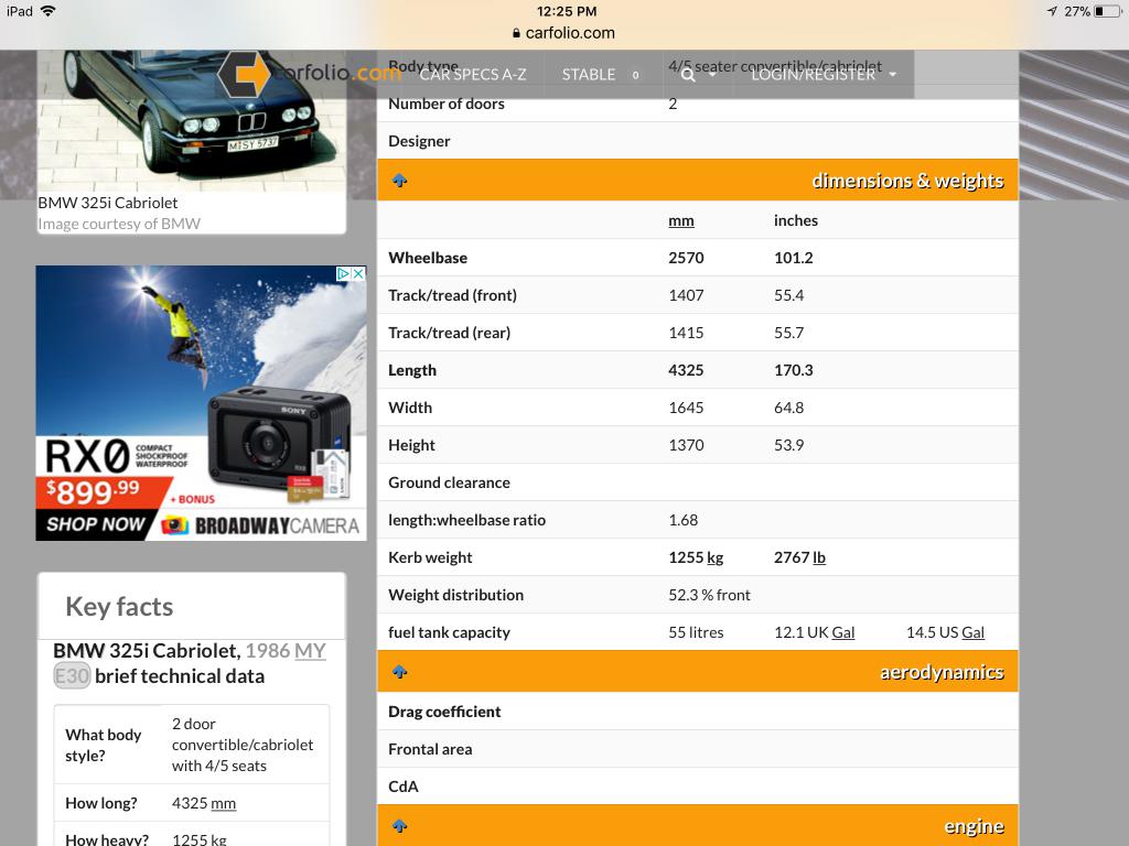

            Looking around in Europe where tourings are commonplace.... I see different shocks for the touring vs cabrio.
            While we are talking suspension here are e30 vs cabrio vs touring weight/distribution for reference...
            I hope pics show up inthread if they don’t can someone post them some external link is not required.
                          Great info! Using your attachments, here are the F/R weights.
                          1396/1269 Sedan
                          1447/1320 Cab
                          1428/1372 Touring
                          So the difference in front weight from the sedan is 33 lbs for the touring and 51 lbs for the cabrio. The rear difference is 103 for the touring and 51 for the cabrio.
                          Per the H&R site they only make the "OE Sport" springs for the sedan/coupe. Has anyone tried these springs on a cabrio or touring?
                            1396/1269 Sedan
                            1447/1320 Cab
                            1428/1372 Touring
                            Cory
                            The weight distribution doesn't tell the whole picture. The touring has a significantly larger percentage of its rear weight behind the rear axle. Quite a bit more than the sedan or cabrio do.
                            I can tell you from my experience, that 475lb rear springs were no where near adequate to keep the rear end from bouncing around like crazy. This was a Ground Control coilover setup, and at full ride height, I would still bottom out with people in the back seat.
                            It took 700 lb rear springs to make the back end feel nice and tight.
