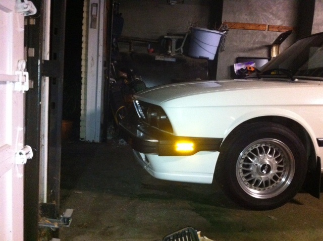

    thought on these wheels? i can get em for a steal.
      If the wheels & tires fit without rubbing, and you like them, get them.
