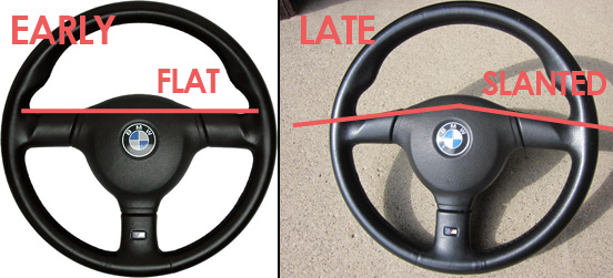

              yeah, so if the early mtech II wheel didn't fit, you have the late model splines. the early mtech II has flat cross spokes, the late the spokes slant downward as they go out.
                  Interesting, but sure enough I have the early M tech 2 in my e30. This means the late M Tech 2 is only made to fit for SRS or thicker spindle?
