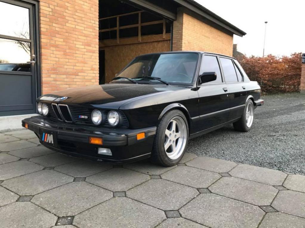

    Im considering buying an E28 M5 thats come up for sale near me, and its pretty cheap since it has trouble with second gear.
    Its a Florida car, and seller claims it has no rust at all, except for a small spot on one of the doors.
    Its gone 146000 miles, with dealer documented service until 90000 miles. It also has a Dinan kit which supposedly consists of cam(s?), chip, air filter and exhaust.
    Anything in particular i should be aware of? Generel E28 weaknesses and such? S38B35 known problems?

          Rust around the left rear bumper shock mount is very common. Otherwise the chassis is basically the same as a typical e28. Rust around windows, rust in the trunk, pointless and probably broken SLS. Worn out front links and thrust bushings. Sloppy steering boxes.
          The motor is fancy and takes an appropriate amount of work to be right. Some have problems with heads cracking between valve seats. Burning exhaust valves is not unheard of, but can be found relatively easily during the complicated but necessary shim-based valve adjustment procedure. Chain guides have almost certainly not been done and should be. I've taken a set out of a 188K-mile motor that looked like they were really really ready to go.
          The transmissions frequently have 2nd gear syncro issues and are uncommon and expensive to rebuild, so most people who replace them put in a getrag 265 instead of the 280.

            This one has trouble getting into second, thats why its cheap. Not that afraid to rebuild it it myself, am afraid of the cost though.

              it's all three. The lower ones more so than the upper one. You can hear the chain slap pretty distinctly if they're worn.

              SLS = Self Leveling Suspension, a hydraulic abortion of a rear suspension system. most failed in the 90s and have been disabled.

                  Chains and guilds are not easy to change, but not impossible and not cheap... about $1200 in parts and who knows in labor if you paid someone.
                  The S38B35 engine is not cheap to rebuild... I've seen $12k bills on a basic rebuild. And parts are getting harder to find and more expensive.

                        They are sturdy cars but rust is definitely a concern. If it's showing any then you can bet there's more hiding in other areas. I agree on the chain guides as well. At the very least get the S50/S52 timing chain tensioner installed right away and check for signs of guide disintegration.

                          My S38 had bad valve guides, a cracked valve and worn chain guides. I did all the disassembly and assembly work myself, paid for parts and head machining only. Spent about $2500 total.

                            you can't swap the bottom one without either cutting a bunch of it off or pulling the head
