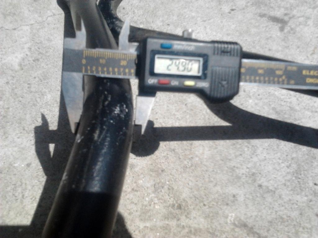

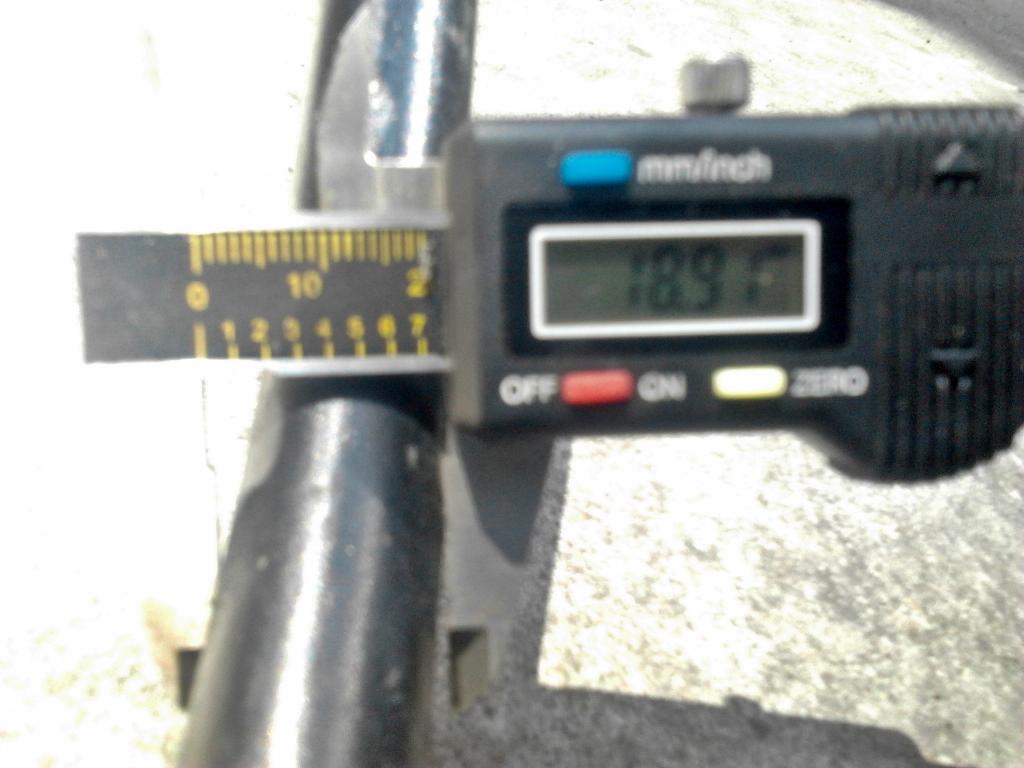

            Sway bars I got are 25mm front and 19mm rear. $160 shipped

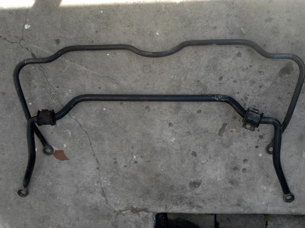

                I believed it's oem sway bars, rear sway bar bushings and brackets included.
                  [ATTACH]70996[/ATTACH]
                  So that would make these M5 bars, as that was the only one to come with 25/18 bars. What makes you sure these are 25/18? Are there any part numbers on them to verify what they are?
                  On closer inspection, that looks like the front bar has the bracket, not the rear (the top one has a kink in it to clear to diff). Does anyone know if I can reuse the stock 528e bracket for the M5 RSB?

                        Front & rear bushings and brackets included with sway bars.
                          [ATTACH]71030[/ATTACH]
                          [ATTACH]71031[/ATTACH]
                          Awesome! I was getting worried because I'm having trouble finding any M5 brackets for sale. I take it you found the other brackets lying around? Can I bug you for a pic of the F+R brackets?
