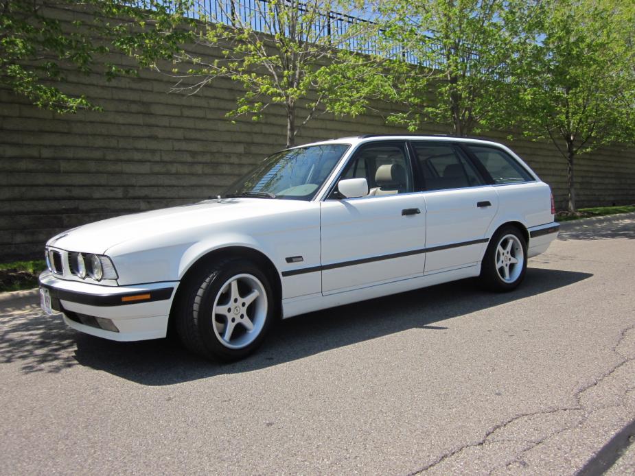

    Just in case anyone is interested, I'm putting my '95 Touring and '91 5 speed donor car on the market in the next few days. My wife decided she wants an E46 xiT now...

    About to swap my '95 525 touring, have a '95 parts car to pull parts from, glad I found this thread as a resource!

    Just an FYI for the doubters...
