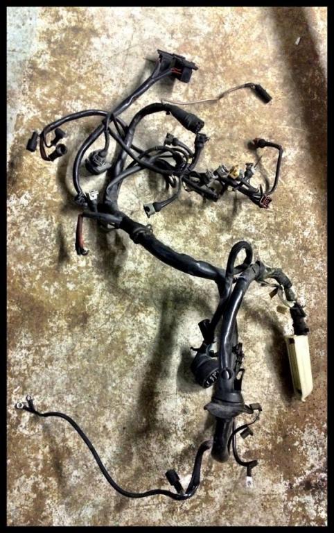

    Can anyone tell my what car this wiring harness came off of? I think its an e28 but I am very confused. Thank you!

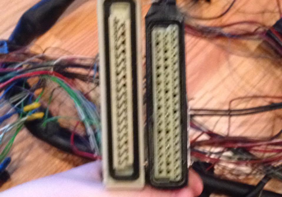

    In picture the right DME plug is from an E30 and the left is the mystery!

    It is from an early (Motronic 1.0) car. Not 1.3.
    See: http://www.e30zone.net/e30zonewiki/i...hp/ECU_Pinouts
    I'd say it's from an M30B34 based E28, but your picture does not make it easy to identify.
      I think you're spot on. It looks like it has the ac sensor spade connectors just past the firewall grommet.
