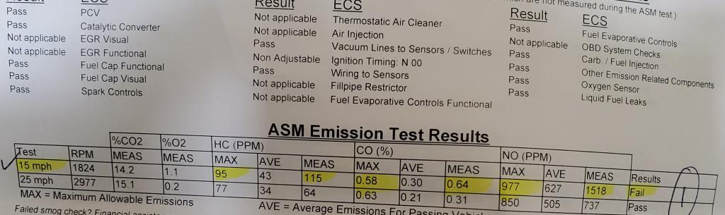

ID:	10025621 just took my e30 to smog and it failed the 15mph. any suggestions why?

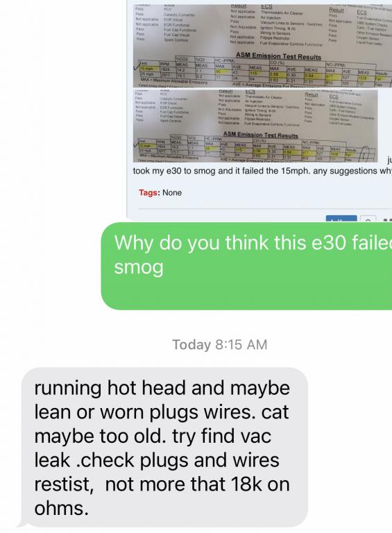

          I texted my buddy Frank. He is a mechanic for 47 years. He has 16 BMW’s from 70’s and 80’s.
          This what he texted me today.

            i think it might be the cat. i bought it used a few years back and always kind of smells gas all the time. ill change the plugs and test the wires. ill clean the cap/rotor, bought those like a year ago. the blaster coil thing is new too. i might need a new boot since the little nipple is kind of cracking. i really appreciate the replies. thank you guys!

              It's running rich at the lower speed...
              when was the last time you did an oxygen sensor?
                t
                outside the RTA infection zone
                few years back.
