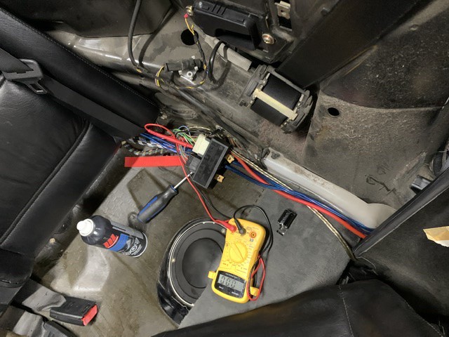

          • Kavadarci
            • May 2021
            • 59
            Found it
            it's behind rear driver side panel
            it does get 12v and all looks good
            same with the third stop light mall cleaned and measures ok
            What else to check?

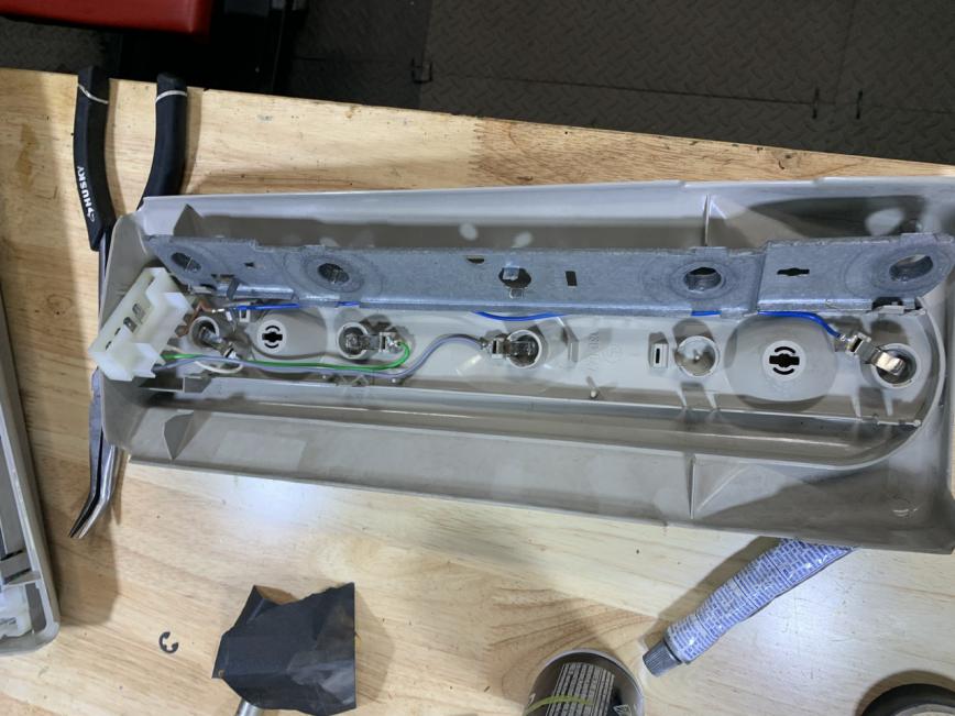

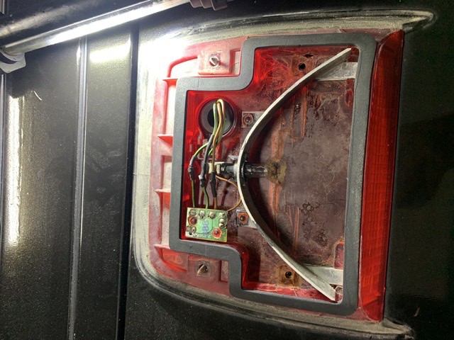

              • Kavadarci
                • May 2021
                • 59
                Ok,
                I’ve check the relay and it is as expected.
                i cleaned every connector even removed the plastic back of the tail lights.
                i tried different bulbs and the light is still there.
                unless I’ve missed something I really start to believe it is something with the dash cluster.
                i don’t have the rpm gauge and temperature working and sometimes on a bump the brake lining light shows up.
                light hit on the dash and it goes away.
                does the dash problem have something to do with the brake light problem I have? Wondering what is the connection.
                i do plan to take it out and fix it.
