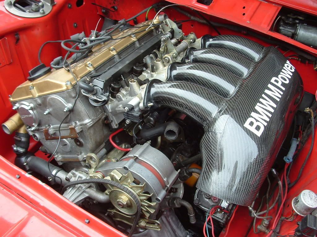

    Just curious. Anyone know the size differences between the e30 and 2002 engine bays? Either dimensions or pictures would be great. Thanks

    local shop has fit m42 into it... if thats of any help : )

      About 6" shorter. Perhaps the same width.

        M20's and 24v's have also been fit.

          M20 swap requires to cut the front rad core to move the rad forward.
          M50 swap requires the same as above as well as cutting the firewall.
          S14 swap is possible too.

              Thanks for the responses. Anyone have a pic of the bare engine bay? I'm curious if certain things like the steering column or brake booster usually get in the way of swaps.
              Right now i'm looking to pick up a project car this summer and i'm thinking about a Datsun 510 or a 2002 and wanted to see what kind of options i had for more power ie an engine swap.
