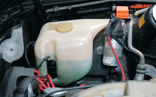

    Grainy picture which does not help.

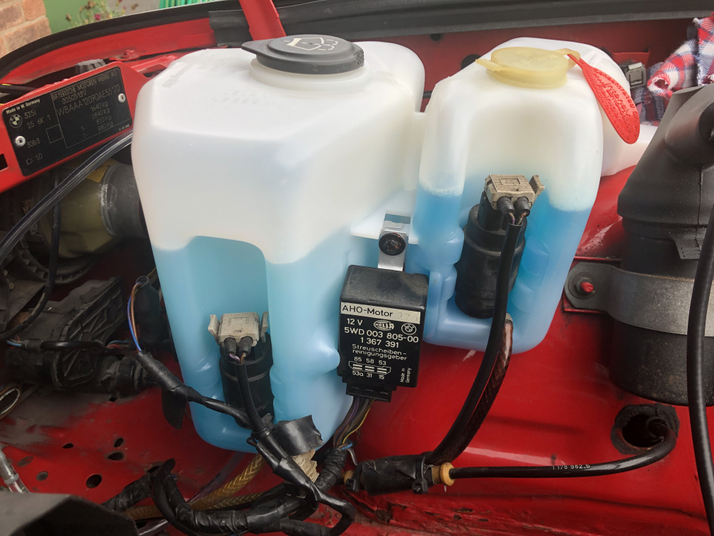

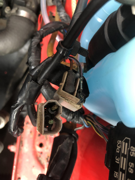

      Clear pictures of the gigantic reservoir and connectors:
      Click image for larger version  Name:	h8X3azK.jpg Views:	0 Size:	160.0 KB ID:	10112666 Click image for larger version  Name:	OFNzf2W.jpg Views:	0 Size:	266.2 KB ID:	10112667

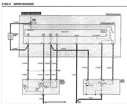

        All right, all figured out. Guess I was wiped out last night.
        Both wires will short to ground with key off and both wires will have positive voltage with the ignition in position 1 or 2. When you break the wash switch it shorts BLACK/BROWN to ground and activates the pump. Had the wife pull the wash switch with the ignition on and was able to determine which wire was which in my custom loom. Diagram attached in case anyone gets back to this place in the future. Case closed.
        *Edit - Forgot to mention the smaller connector for US Spec OEM is the BK/BR.
