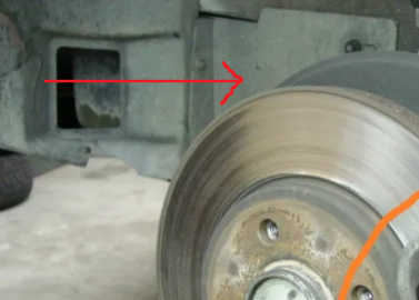

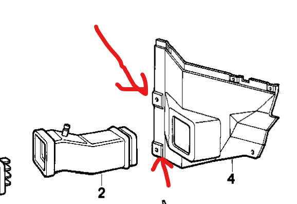

    Can anyone help me identify this part number? Been through Re
    aloem and various catalogs online and can't seem to locate it. Looking for these plastic covers which are attached to the air duct panels that are missing from my car. I have an arrow pointing to the plastic cover part in the first pic and the place that it attaches to in the 2nd. Thanks in advance!

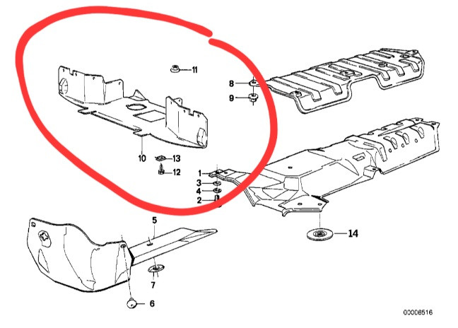

    You were so close...
    Realoem list three of them. #10
    1. Early cars without A/C
    2. Early cars with A/C
    3. Cars after 1987
    You'll probably want pn. 51711965899

        Yep that’s what I need, thank you! Since I never had one I didn’t realize those covers were actually just part of a larger part that wrapped around the bottom. 😬 Appreciate it!

          I just replaced this. It took me a while to figure it out since the depiction on realoem isn't representative of our cars. the correct PN is 51711965899​​, engine compartment screening.
