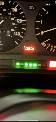

                On another note, could this have had some effect on my service indicator lights? When I got the car a few days ago….the second to left green light was not on but the other four were (see picture). I don’t think that’s how it works normally….so I figured I had a burnt out bulb or a bad solder on that second to left LED.
                However, I noticed today all 5 green ones are lit. Could spraying contact cleaner on that headlight switch have fixed that? I know the dimmer controls the instrument cluster dim, too…..but I don’t think the service indicator lights or the warning lights next to it (brake lining, etc) dim even when you dim the brightness to the lowest setting.

                  Edit: now only 4 are lighting up again with that second to left burnt out. Oh well.
