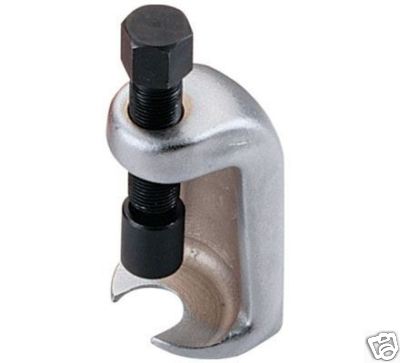

Hey everybody. I recently have started a project on my e30. I am replacing all the worm out rubber bushings on my suspension. I am having trouble separating the ball joint shaft from my front struts, this is the only thing stopping me from pulling my old front struts out. Yes I tried the search function, yes I tried a pickle fork, to no avail. Is there a trick to this, do I just need a BFH, maybe a rivet gun. Any suggestions would be appreciated. Thanks.

get a air imapct hammer or borrow one and a compressor
get a small spike anvil, put the nut on the end of the ball joint 1/2 waythreded and then insent the tip of athe anvil inside, pull trigger for 5 seconds then remove the offending part.
Thsi works for eveything that is pressed in bt time and force...like stub axels and tirerods and ball joints. This is why the tuop of the ball joints is dimpled...for a spike anvil.
I ahve one like this..i think it was 15 bucks with the anvils88 325ic ~~~> Rusty and ugly
