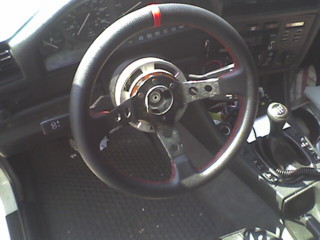

                    DONE!
                    VERY simple operation to simply cut the old wheel loose from the hub, drill new holes in hub, and run some new bolts into the holes. rather than tap the holes i just put nuts on the back (nylocks with washers). I also used some larger nuts between the wheel and hub as spacers so that the horn button wouldnt bottom out against the hub. All told, it took about 2 hours including running to the hardware store for bolts. 2hours + about $9 for bolts, washers and nuts. Compared to a $70 ebay adapter, that comes out to about $30 an hour i just paid myself to do this, which is way more than i make at my day job/s currently.
                    I took pics but am too lazy to post em right now. This retains the stock steering lock and I didnt have to mess with the airbag "pin" in the column or anything else attached to the car. I may wrap the bare hub with some kind of fabric tape to cover the front of it, and the stock padded cover will conceal the outside of the hub (once i put it back... too freegin hot out there to continue to mess with it now).
                    One last thing, i was only able to put five of the six bolts into the hub, due to one void area below the bottom-most bolt. This is fixable by bridging the void on the back of the hub with a heavy piece of scrap metal, and then running the bolt through that. Right now im not worried about it.
                    What remains of the stock wheel is destined for use in the other e30 in the family...

                    • robspeed325i
                      • 403
                      crappy cell phone pic!
                      yea my car is filthy and it was 98 in the shade today while i was doing this so i didnt bother finishing the horn wiring or making things pretty. wheel is solidly mounted and i have room for my knees now... strange that a much-smaller car (my old 69 02) had so much more room in it...
