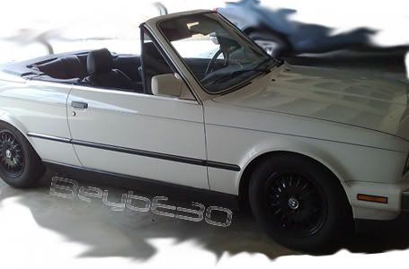

    how's everyone doing? I purchased an e30 about a month ago. I am having some issues with the MPG on the car. the car was converted from 2.5L to 2.7L and the camshaft was change into 288 and it has a Dinan D900-2532. I understand that with all those upgraded items the car would lessen the MPG a lil' bit. However, last saturday i had it full tank. while looking at the gas meter awhile ago the gas was already in the mid range and the car has only traveled 44MILES. What should i do?
    btw, i changed the oil 2 weeks ago.
    the car is running in about 3k-4k RPM
    Thank you for reading
