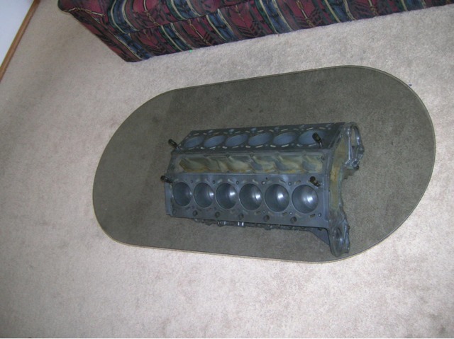

                          Go this route
                          Cheaper and easier ways to get 300hp in an e30. Granted the m70 is a VERY cool engine, the practicality is just not there. Of course if you have the budget please to a thorough build thread!
