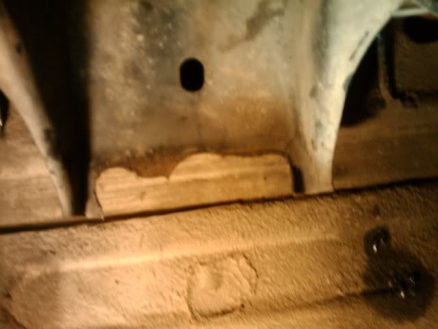

          Got another skf from kragen and this one worked out. Now I have a subframe issue to adress. Someone pulled the diff before and didnt reuse the washers and I found this.
          So I'm gonna weld a plate into there and brace the subframe.
