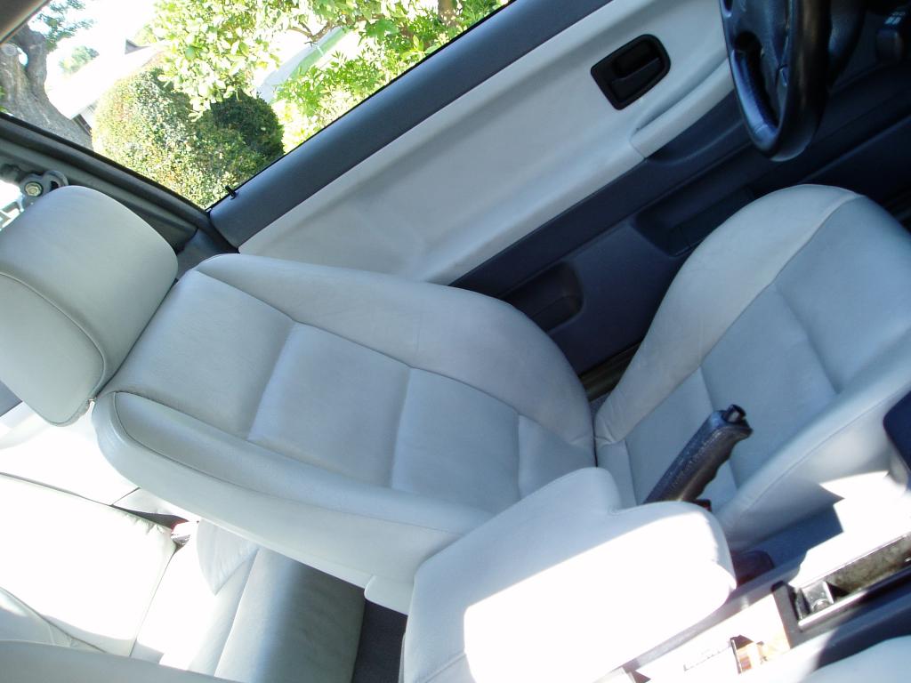

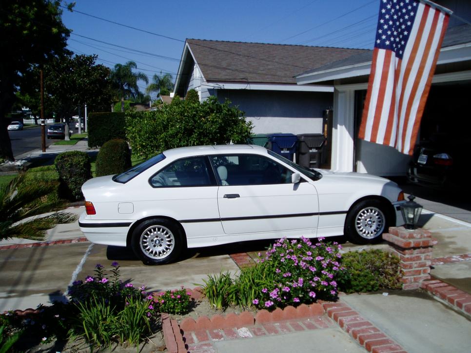

                                This is my DD. 187k miles and still rockin the cassette deck.
