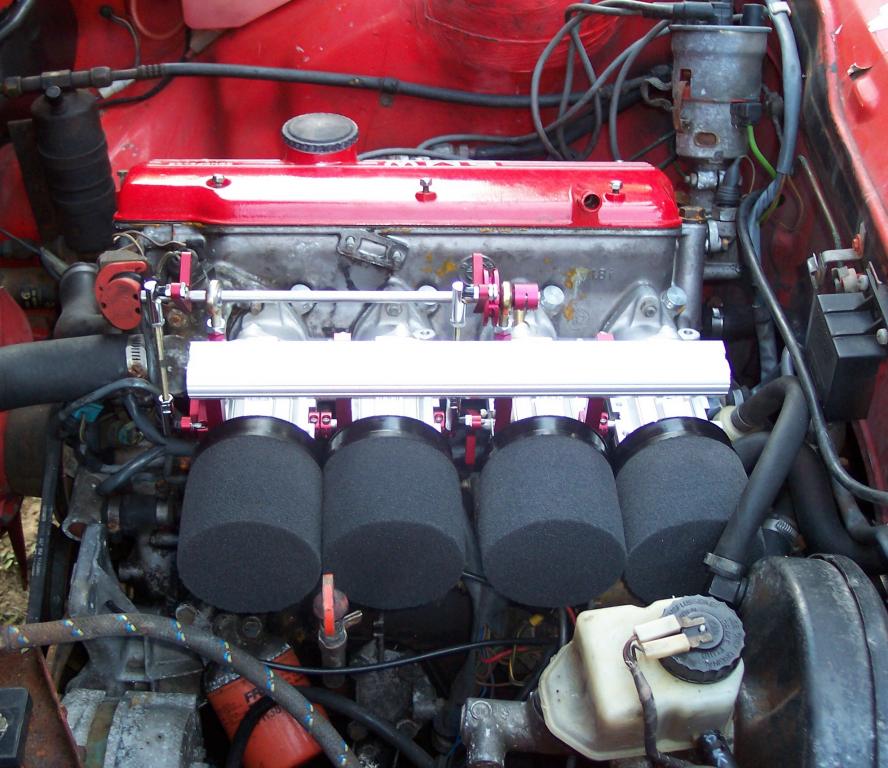

    Met Kevin, owner of www.extrudabody.com a while ago when I was researching alternatives to Dbilas set up.
    Not only a great guy but his stuff is amazing quality. A true car nut at heart. We will be working with him as his Northeast supplier as we have several customers who would like an ITB set up on their cars.
    He just sent me these pictures of a e21 he picked up, it was suppose to be just a daily car, but he couldnt help himself...

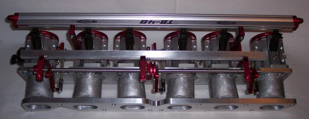

    Linkage is changeable from very quick response to Long and Controlled, by moving the Ball stud Joints from arm to arm . Same works on all his 4 and 6 Linkage systems with Standard size Injectors!

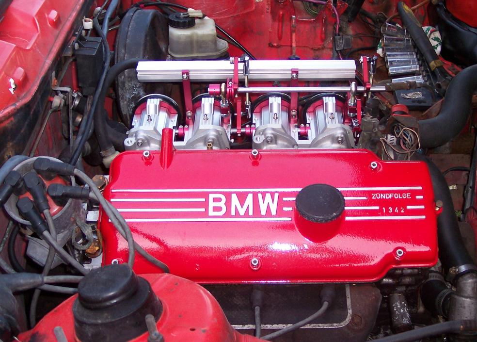

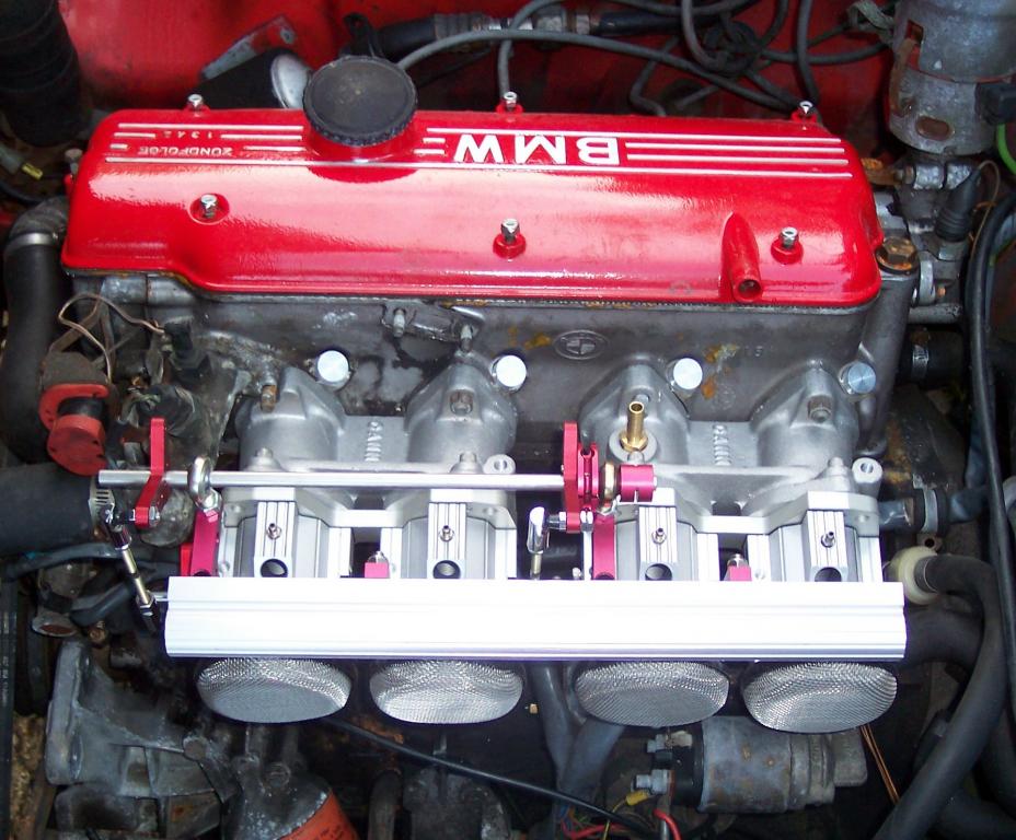

      Another from the fitment testing. Will get video up of it running soon as testing complete.

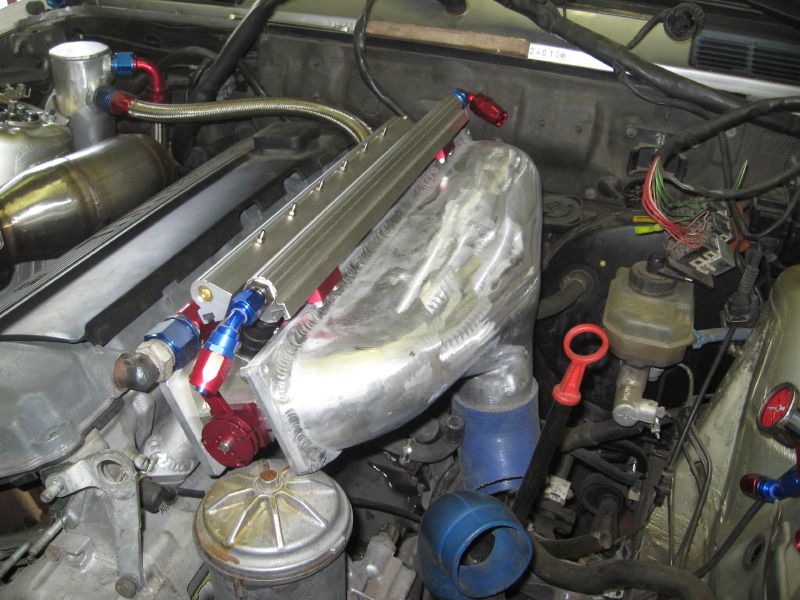

                      Check out this beast... 48mm custom for a customer in Dubai.

                            Guys to add our experience to a few Myths:
                            First and foremost Extrudabody is NOT like any other Company! We innovate and do not follow convential rules.
                            Trumpets and Plenums: Trumpets protruding into a Plenum is not the way to make power...... air entering one end, center or the other WILL TAKE the path of least resistance filling 1 cylinder over another unless the plenum is huge, sonic waves back into the plenum further disrupts this flow reaking havoc for cylinder to cylinder balance! The slight increase you get from a colder air charge is NOT offset by the Plenum embalance from cylinder to cylinder. If you want cold air induction Isolate/segment the engine bay and feed cold air to it!
                            Now factor in the fact that most ECU's are batch fired injectors, which means all are spraying the same amount of fuel, with each runner flowing different amounts of air this means some are rich and some are lean! Ok for the rich ones, not so good for the lean ones! The ECU's that are Sequential or have Cylinder to cylinder Fuel Trim still requires a Thermocouple or O2 sensor in each exhaust tube to tune the trims.... and this starts driving costs way up
                            Trumpets: What you don't see you still get! Do Trumpets make power or does the Radiused edge that rolls the Airflow into the Body make power? Most all ITB/Weber trumpets have a small 1/4" to 5/16" bead or rolled edge. we used 1/2" with the 45mm and 48mm Taper bore ITB's. The Velocity stack is built into the ITB Body!
                            Here's a bone stock VK5.6ltr V8 from Nissan that made 401hp @ the Wheels with 45mm Taper Bores, Jim Wolf Cams and Headers! This was a MAF Sensor based Buggy build. Wolf wanted to run stock electronics, hence the size of that Plenum, you still do not see Trumpets protruding into a plenum, as it's hard enough to get high velocity air to turn, imagine trying toget it to make a 180 degree turn around the LIP of a Trumpet!
