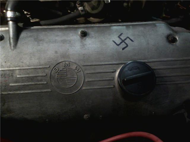

    So today at work I had the rare opportunity to turn a wrench on this beauty!
    I'll post picture after a quick story:
    Guy calls and says he has had his car at a Dodge dealership about an hour and a half away(outatowner) for 2 weeks. Car cranks, but wont start. They said it wasn't getting a good enough spark. Put an alternator and a battery in. Still no start. They checked fuel pressure and no fuel pressure. They put a new intake pump in it. Still no start. After two weeks of them messin with it he has it towed to Wichita for us to look at it.
    I pull fuel line off the car, and have a guy crank it. No gas at all at the rail. Check the in-line pump-good. Check the intank pump-good. I remove the intake pump and what do I see? NO FUCKING GAS. How can you replace an intank pump and not notice? Losers. Put 5 gallons in it and it started right up.
    To the shops defense I did notice when the car came in the fuel guage read 1/2. So obviously he has a fuel level or cluster issue. Now to the picture of the rare beast. Based on this one picture you can guage a feel for how the rest of the car is:
    Dont know if you can tell in the picture but it has a Mercedes Oil Filler cap...
    More pics maybe tomorrow
    Kyle
    And for those who cant tell: Its a rare White Power 84 318i. The ironic part is the car is full of Camel Menthol cigarette cartons.

        whats with the swastika?

                    pics of the rest of the car? and who on earth puts a swastika on the valve cover????
