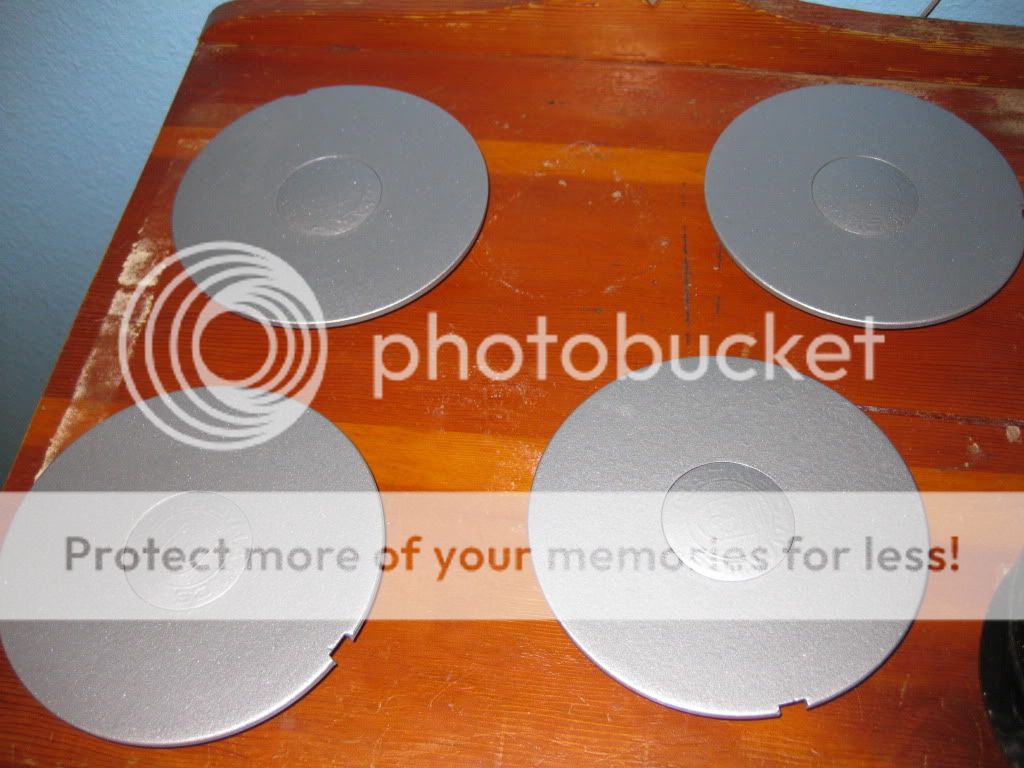

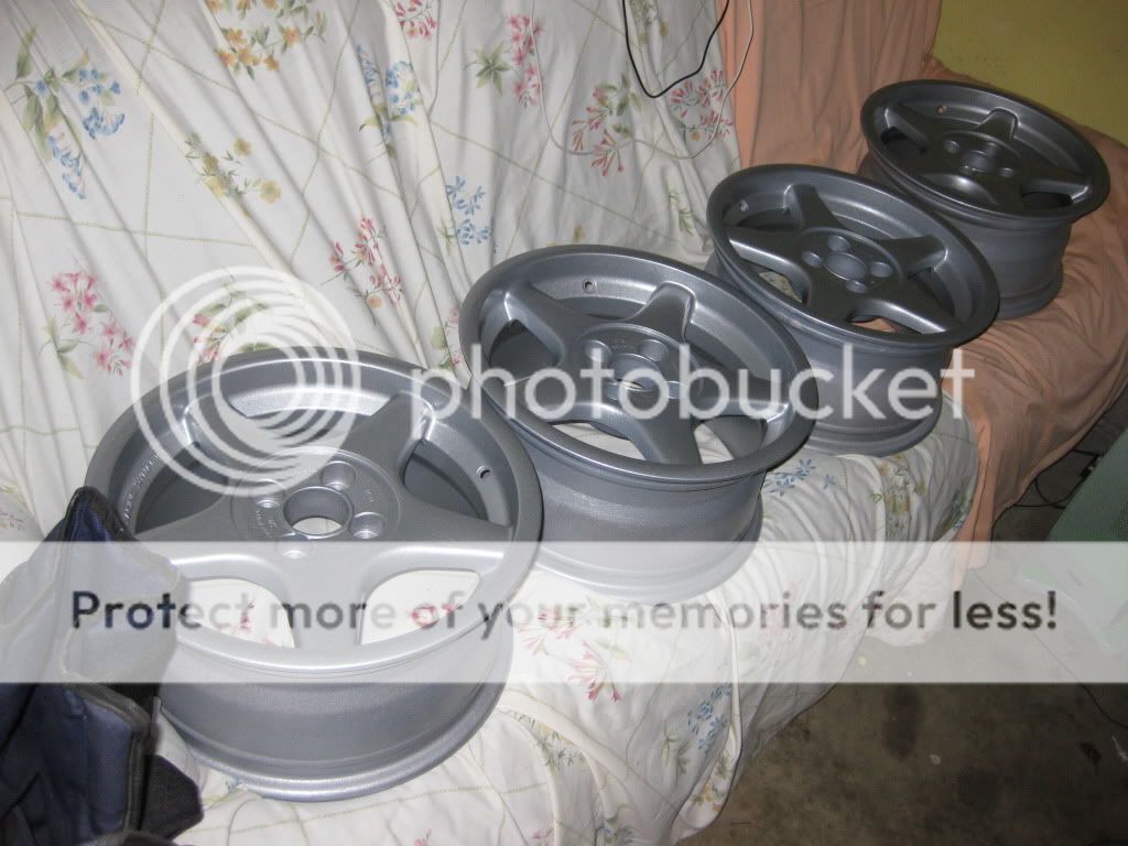

            • Wishno87
              • 6025
              Its the Acura paint
              • robrez
                • Jul 2008
                • 3376
                Looks great. How did you go about it? Did you give the paint code to the painter or did you buy the paint and DIY? Also, just to confirm, the wheels were painted, not powedercoated, right? Thanks.
                January 2012 COTM
                • Wishno87
                  • 6025
                  I bought the paint and my dad painted them. Powdercoat is horrible for aluminum wheels so i dident go that route but a pair of them had already been powdercoated by the PO :( Unfortunantly my dad dident know he wasent supposed to paint the emblems.
                  Everything turned out alright but my dad had trouble painting the metallic because its a very heavy paint.
