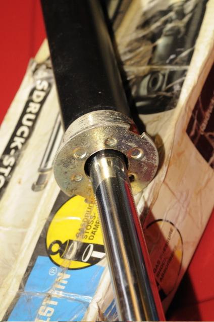

                            40mm bilstein with 51mm nut
                            • richardkeith97
                              • 1693
                              well the IS is in a garage till march but i checked realoem.com and it says spring strut 51mm for both my cars. pelicanparts.com says 45mm only came on the 318. that nut looks like the one on my eta. i need the stock threaded ring with external nut though if anyone has one. i must of thrown mine out when i did my suspenion and i'm gona need it to put my stock shocks back in.
                              • richardkeith97
                                • 1693
                                i need this one. two of them
