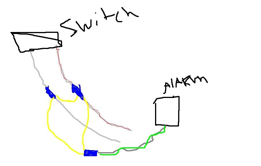

                    • e30:)
                      • 728
                      i have power to the grey/red wire but this could be contributing to my problem, the po had an alarm that i have never gotten a keyfob for so i dont know if it wirks or not.
                      this is the situation

                        • bimmer_E30
                          • 5001
                          LOL

                          • kid325e
                            • Sep 2007
                            • 6422
                            love the gray wire with red stripe. fix it right the first time junior!

                            • StereoInstaller1
                              GAS
                              • 22679
                              No, the alarm is not causing an issue.
                              Well, at least not that issue.
