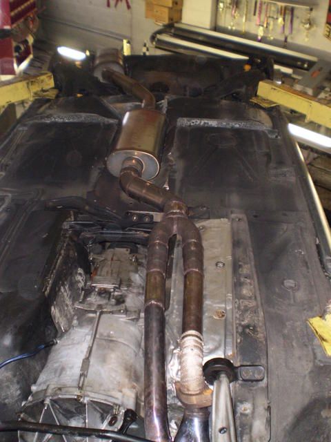

            i used a magna flow 2 1/2" dual in/out for a resonator in my car with a 2.7 stroker ITB's etc etc no cat and a stromg catback. it was too buzzy with 2 cherry bomb glass packs that i tried first so i went with the small muffler next and love it. the muffler is smallenough to fit in the channel where cat section usually goes with a cat if you put it towards the rear part of the section. nice sound, not buzzy, quiet-ish until you get on it.
            i need to remake it because when i did it i ran out of gas for my mig (so the welds look like crap and i had to use some less than optimal bends just to get it back together so i could get it back together.
            when i get to my desk top i will add the partnumber to the post so you can check out the deminsions.

              So, the E36M3 bits WILL fit the E30! Then I can just buy a E36M3 sport exhaust or at least a cat back and make the rest my self.
              I have a couple of shots from custom exhaust, but most do not run silencer or resonator under the car. Only a rear silencer.

                          do the 2 muffler route. i love the way mine sounds, agressive and throaty when i get on it, but no drone at cruse and a nice low rumble at idle with the 292* cam.
                          when i had my jetta with no cat and 2 mufflers (1 resonator and 1 muffler) i ended up running a glasspack in a straight section to knock out the raspberry sound when accelerating. it also sounded great with the big cam set i had in it.
