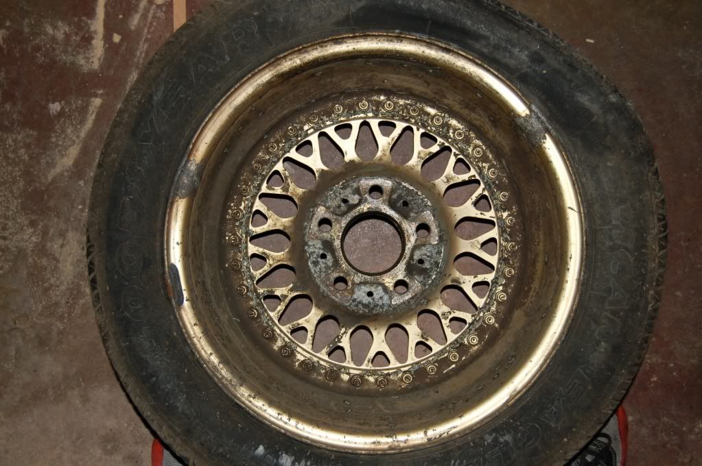

            The wheels may not be redrillable. Check the back part of the wheel hub. If it's flat without any additional holes (other then the lug holes) then they're redrillable. If the back part of the wheel hub appears to look like a raised star, they're not redrillable.
                        yep, the 005's dont have flat backing plates. also, 4x100 is too small for the hub diameter of the 005's as the have the larger diameter hub bore.
                        here is the inside of a 005 to show what oomph was talking about.
                        -Dan
