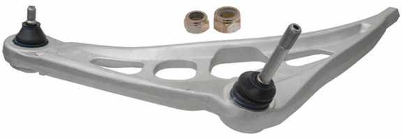

                    Found this at napa auto... $118. not sure who made it?
                    http://www.napaonline.com/Search/Det...+50006+2006005#
                    I think it's an E46 lower arm but it says it fits a 318,325,M3?
                        I'm not a guro when it comes to bmw supention
                        That's an e46 control arm. Sure, it will fit 318/325/m3, but in the e46 body style.
                        Just get a set of Lemforder e30 arms.
