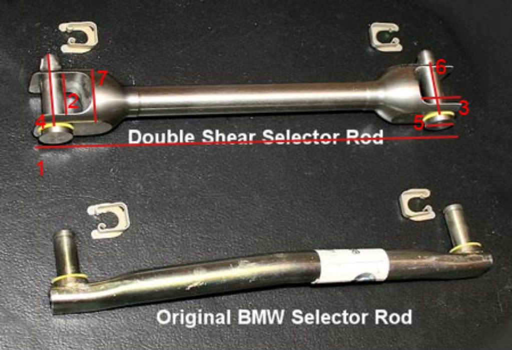

    I've got a huge favor to ask. Hopefully one of you will have one uninstalled. I need the dimensions so my buddy can make me one.
    1-Overall length of the DSSR
    2-Width of the inside of the gaps at the ends.
    3-Length of the gap
    4-Total Length of Pin
    5-Diameter of the top of the pin
    6-Length from top of pin to the groove in the pin for the clip.
    7-Total Width of the ends
    8-Oh And I forgot I'll need the diameter of the hole for the pin!
    I think that might be all I need. Remind me if I'm missing something important. I would really really really appreciate it if you guys can provide me with these dimensions!

            OP have your machinist measure up your existing one. The only crucial dimension is center to center on the pins and pin width which will be your inside width on the new design. Also measure the area these pins sit in on the transmission and shifter shaft to give enough clearance.
                  Thanks for the support man. They don't realize how much companies overprice stupid machined parts. They buy the aluminum dirt cheap probably in mass quantities and produce a million of these things and then make back the price of the material than threefold. I support little guys who try to make parts for cheaper. I forked up $35 dollars for silence's tiny power steering delete, because he's trying to help us out. UUC is just trying to make MONEY.
                  Thanks for the helpful and intelligent reply and I'll listen to what you said and have him look at my existing one.
