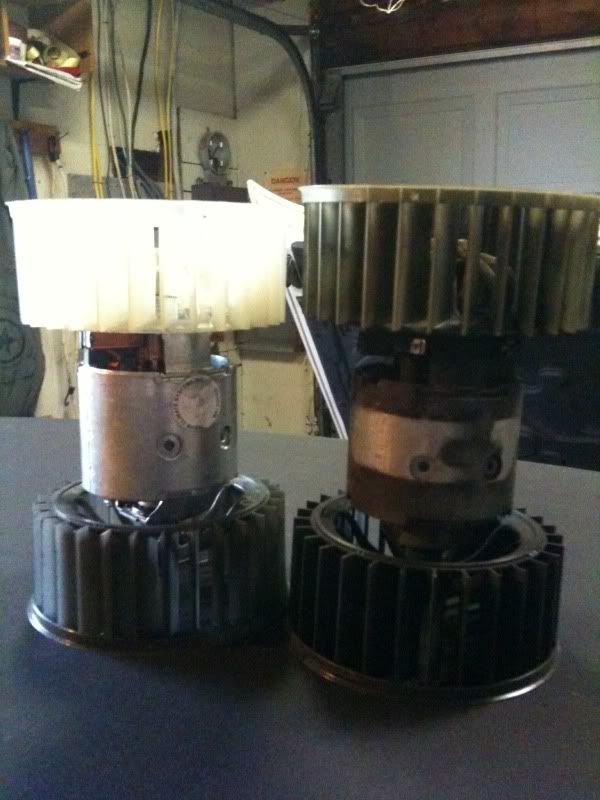

    Fucking OEM suppliers cant even get it right! the fins are too close together and wont fit without rubbing. Is there any adjustment to the width of the fins from the motor?

    Can't you remove the old blower wheels and put them on the new motor?

      your supplier isnt aware there are 2 versions,. 3 if you count the canadian version
      send it back

        I triple checked and only saw 2 part #s. then had bma double check for me too. I'll report back when this gets straightened out.
          no, it's finely balanced because it spins at thousands of RPM. the bearings will shit themselves.. ask me how I know. :(

            Ahh I see. I've noticed those balance weight clips on on the blades before, I guess it would be balanced as a unit too wouldn't it.

              There's more than one type of blower motor. Need to be specific when ordering.
