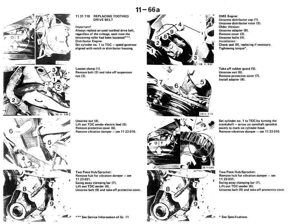

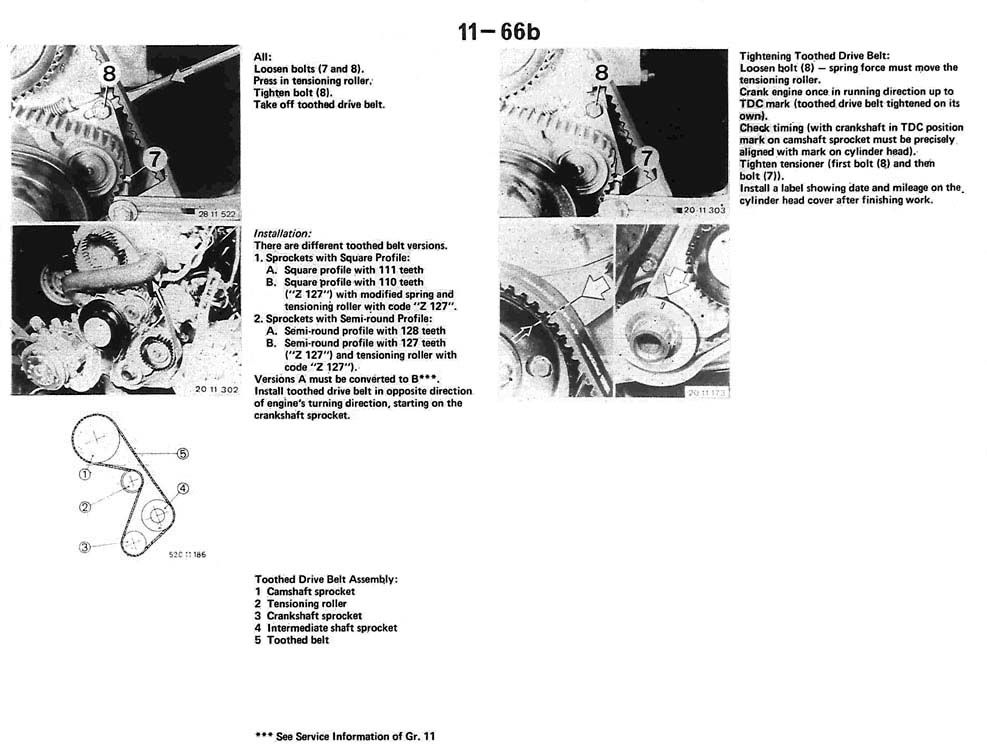

      Compress the tensioner all the way and tighten the bolt to keep it compressed while you fit the belt.
      Only put the belt halfway in, don't push the belt all the way on the sprocket toward the engine. Follow the numerical order and it will go on fine, albeit tight.
      [IMG]http://www.r3vlimited.com/board/
      • nando
        • 34844
        you have to pull the belt to move it one tooth, but don't sweat it. follow these guy's instructions to get it lined back up correctly.

          Follow that ^^^. Also what i do is get a white paint pen and mark the position of the belt on all the pulleys before you slide it on and put tension on. Then wind the engine 2 complete revolutions and see if your marks line back up on ur cam and your crank pulley. First time i did my belt it went on piece of piss but then i rolled it over and the cam was off 1 tooth.

                              loosen tensioner bolt, turn engine two revs and check again. If all is well, tighten tensioner and done. If not......
