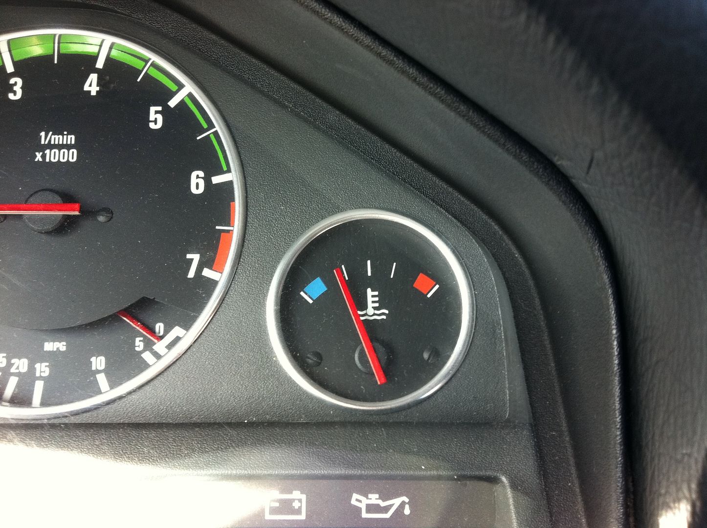

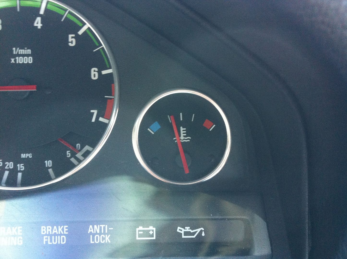

        The engine is running only water for about 6 months and the guage doesnt get beyond the first white line the one before the middle one, well it moves around both lines but stay closer to the first one not the middle one.

                    Here are some pics showing where my temp gauge fluctuates

                          its burning a little oil. as long as your oil looks good and coolant is stable and clean just drive it. Get something in the coolant though to prevent corrosion. even water wetter or something
                          edit and dont rev it like that with no load on it
