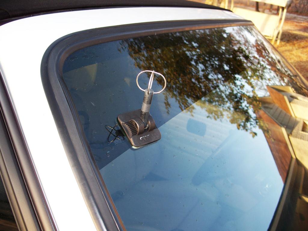

    is there a hole in my windshield ?
    bought my car wired this way, I'm assuming it was an old school cell phone antenna. Ive never taken one apart much less seen one. Was there a hole drilled to install this unit ? thx

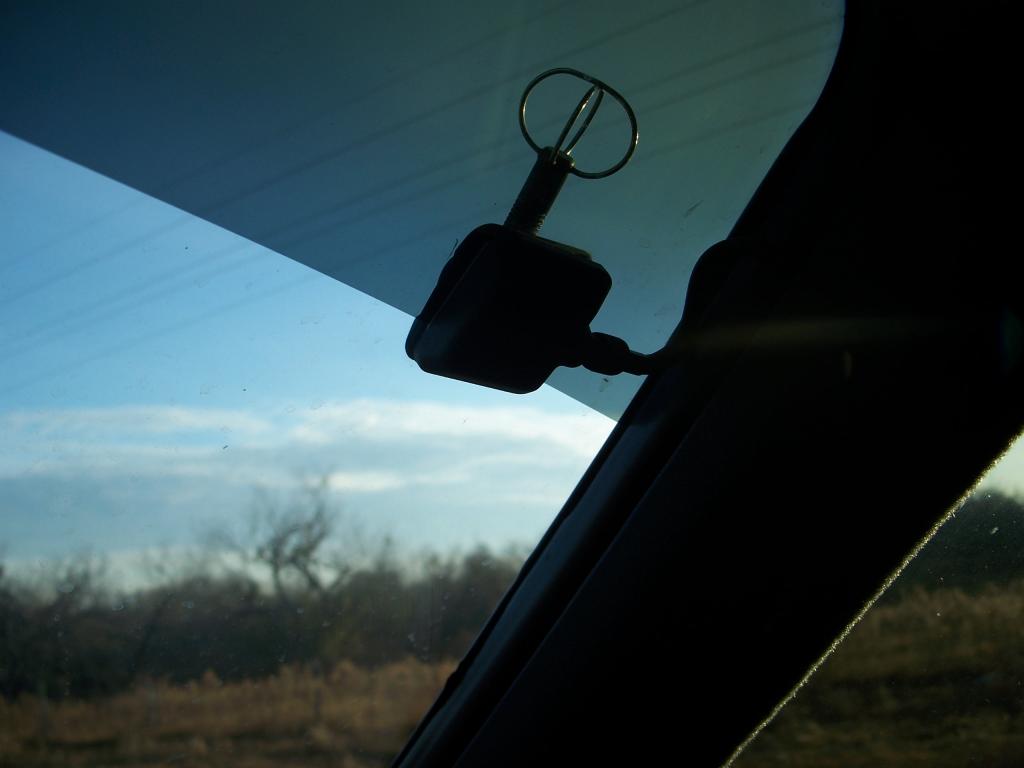

    never seen one, what does the inside look like?

      Old School....
      There's no hole...just super sticky tape

          glued but i've never seen an antenna that looked like that.

              its an old school cellphone antenna, i believe. and there is no hole it's passive through the glass. a coil on each side sends and receive the signal.
                  like this

                    there is not a hole in your windshield. use a hair dryer to heat up the base of the antenna. then use a plastic putty knife to slowly work loose.

                      you can also use fishing line, and a razor blade to remove whats left

                        if there is no hole, how does the wire reach the antenna?

                            Like Cabriolet said, there is a coil on each side of the glass. Power going through the coil on the inside creates a magnetic field which induces a current on the coil on the outside. Works just like the charger for a cordless electric toothbrush. Tesla had ideas using this for wireless power over miles of distance, but a lot of people thought it might interfere with the Earth's magnetic field and cause havoc.
