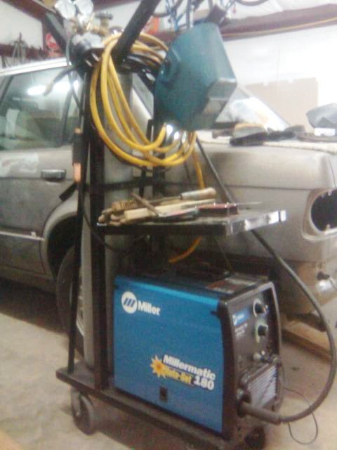

                      I use the Lincoln Tig at my roommates grampas house it's water cooled and works great.
                      Looks like this
                      • expressfish
                        • May 2008
                        • 526
                        get ya one of these, a bottle of argon, and one of co2 mix. You'll be able to do anything you want if you can run a bead. you might add a spoolgun in there too if you want to stitch aluminum.
