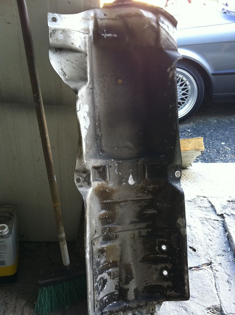

                    Ok guys in my case, i had the car on the lift today and diagnosed the thud ive been feeling. satarted with the csb. Is this normal csb play?
                    The subframe bushings and guibo looked fine.
                    Before putting the heat shield that covers the driveshaft we noticed that it had some marks on it. So we decided to go around with out it. And guess what the thud/clunk was gone.it seems like if the exhaust tubes were hitting the shield. I will try it couple of days without the shield and see, but again is the csb pkay normal or do i need to replace it? I have no vibrations from the shaft.
                      yes thats normal. What we cant tell from that video is if the csb is weathered or cracked. As long as the rubber surrounding the bearing is in good shape youre fine. its supposed to move around like that
                        Yeah the surroundings looked fine in place and new, it wasnot cracked at all but the play it had i thoughtit wasnt normal, but again as i dont have any shaft vibrations/ clunking when shifting up or down/ depressing the clutch etc... The csb is discarded. You can see in the pics below towards the center and at the top where the exhaust was rubbing. Amazing how you can get confused with the crappy sounds an old car makes one in a while.
