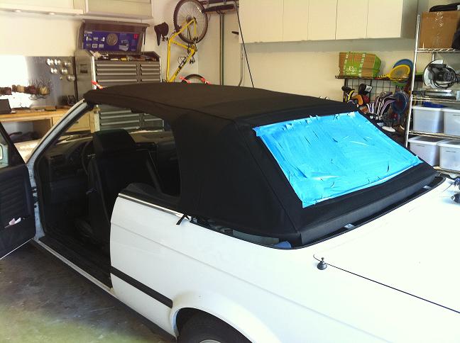

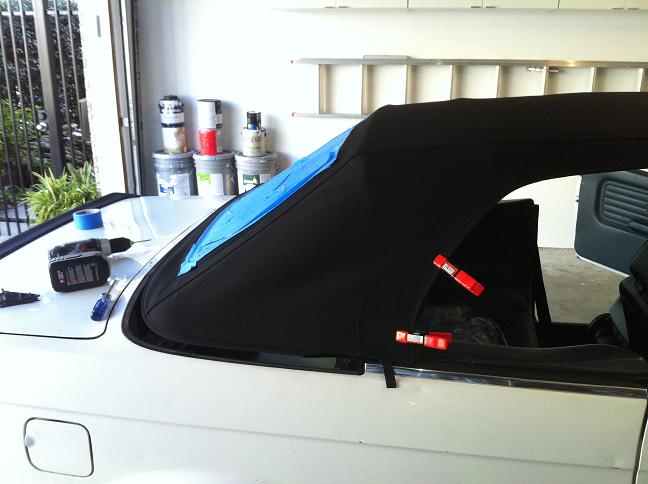

    So, I have my new top stretched over the frame. I'm at the point where I'm prepared to re-assemble everything but I'm hung up on one step. I can not figure out how to access the back of the frame so that I may glue the top in place. The instructions say that I should lift the top up - but when I do so everything comes out of place. It's to the point that I'm considering removing the frame from the car and installing all of it upside down. Additionally, I don't know how I'm going to reach the seal retainer or any of the screws without displacing the top.

      Thanks for the video. I wouldn't have guessed that all of the adhesive goes on first. Another problem I have - my window is WAY more stiff than that one.
